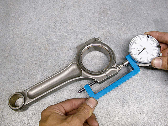

1. Measuring strain in the bolt/stud is the most accurate method.  It takes friction and prevailing torque out of the equation.  Use a micrometer to measure how much your bolt stretches.  This is a common technique for racing engine rod bolts.  And they even make special tools for doing it:
2. Torque the nut using a degree wheel.  Run the nut down until it contacts the washer.  Then turn it "x" number of degrees further.  You can work out how much strain you are producing in the fastener based on the pitch of the thread.

And how you do it with a blind thread where you can not reach both sides of the bolt?
RE: Torque on a nut and relation to axial force?
The best way is to measure the stretch, and knowing the spring stiffness use F=Kx. That is what the ultrasonic device does..
