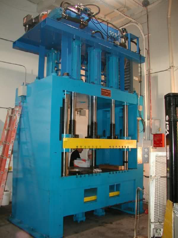

Just a little feed back.
Commissioned the Press today.
Couple of shots of the controller, and of the Press itself.
My controller is working great.  There are a few details with the hydraulics that others will be fine tuning.  None as bad as the hose that was missing so 1,100PSI hydraulic oil shot out the back hitting the wall twenty feet up. LOL
Keith Cress
