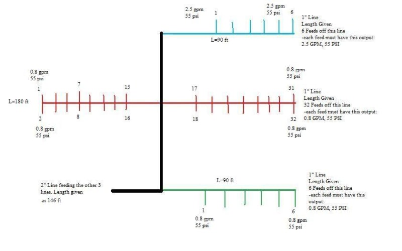

It's been awhile since I've done these calculations, please help.
I have a 2" line feeding 3 other lines (I'll call them A, B, and C).
Line A is a 1" line that has 6 branches coming off of it. Each branch must have an output of 2.5 GPM, 55 PSI.
Line B is a 1" line that has 32 branches coming off of it. Each branch must have an output of 0.8 GPM, 55 PSI.
Line C is a 1" line that has 6 branches coming off of it. Each branch must have an output of 0.8 GPM, 55 PSI.
I need to figure out what size pump, pressure, flow rate I will need to operate. Also, a plate and frame heat exchanger size. I'm guessing I have to work backwards on this.

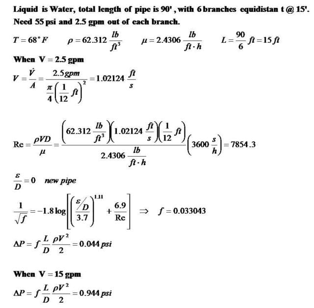

I'm stuck. I'm not sure if I'm doing it the right way.
For example:
Line A: Each branch coming off of it has to have 55 psi and a flow of 2.5 gpm. So I'm thinking that I need a total pressure, at the beginning of Line A, of 55 psi*6=330 psi. The same for the flow... 2.5 gpm*6=15 gpm.
Line B: 55 psi * 32 = 1760 psi (@ beginning of Line B), 0.8 gpm*32=25.6 gpm.
Line C: 55 psi*6=330 psi, 0.8gpm*6=4.8 gpm.
Line 2: Since lines A, B and C are connected to Line 2 (the main line), Line 2 must provide enough pressure (330+1760+330=2420 psi) and flow (15+25.6+4.8=45.4gpm) so each branch can have the desired output, am I right?
Or am I doing this entirely wrong?
RE: Multiple lines feeds
Yes, you're doing this almost entirely "wrong".
Try plotting the Hydraulic Grade Line (HGL) from the discharge points back through the system to the pump or source of flow.  Use the Bernoulli Equation and account for friction losses in the lines using whatever information you have. Those sources may be friction loss tables, the Darcy Weisbach Equation, Manning's Eq., or even the Hazen williams Eq. (if the fluid is water) .
Here is what I've done...hopefully it's a lil more correct. Please let me know. I wasn't so sure about the velocity, so I did it at 2.5 gpm (individual branch) and 15 gpm (all branches=2.5*6=15). The total pressure at the head of this line is 55.84 psi (when you have a drop of 0.04 psi between branches) or roughly 76psi (when Pdrop=1 psi), right?
Doesn't sound like it.  Please post a diagram of your pipe configuration, include flows, lengths and diameters.  Maybe I still don't understand what your system looks like.
here is a quick sketch
Thought so.
Take the end of each branch as a control point where you must have a minimum of 55 psig discharge.
Find the flow losses for each segment, adding the flows in each segment as you go upstream past each outlet cluster.
The flow losses get higher in each 15 ft segment... the flows get bigger.
Sum all the flow losses and add to 55. That's the minumum feed pressure for each branch.
Do for all branches.
The highest feed pressure is what you need to feed any intersection of branches.
Keep going upstream, adding flows and calculating pressure losses.
Take the highest of the minimun feed pressures at any intersection of 2 or more branches.
When you get to the end, you will finally have your feed pressure for the system.
Like this....
http://virtualpipeline.spaces.msn.com
