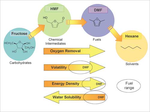

A catalytic process for converting fructose (a common plant sugar, cheaper than sucrose) to a liquid fuel, 2,5-dimethylfuran (DMF), is faster and less energy-intensive than the principal ethanol production process.  Plus, the fuel has a 40% higher energy density (ethanol can be considered partially oxidized ethane), etc.

Ethanol production from corn is rather energy inefficient.  The DMF production is much better:
"It's a very efficient process," says [UW Graduate student George] Huber. "The fuel produced contains 90 percent of the energy found in the carbohydrate and hydrogen feed. If you look at a carbohydrate source such as corn, our new process has the potential to creates twice the energy as is created in using corn to make ethanol."
About 67 percent of the energy required to make ethanol is consumed in fermenting and distilling corn. As a result, ethanol production creates 1.1 units of energy for every unit of energy consumed. In the UW-Madison process, the desired alkanes spontaneously separate from water. No additional heating or distillation is required. The result is the creation of 2.2 units of energy for every unit of energy consumed in energy production.”

Both the University of Wisconsin group cited above and researchers at the Pacific Northwest National Laboratory in Washington (state) are working on fuel from glucose, a cheaper source than fructose. The latter group has published results [Science 15 June 2007, pp. 1597 - 1600] in which the intermediary hydroxymethylfurfural (HMF) was produced by a one-stage catalytic reaction. The Wisconsin group uses a two-stage reaction to transform the HMF to DMF.
