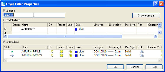

RE: AutoCAD Viewport Problem
Quote (merton):
Just to clarify, there are no frozen layers in the drawing and the items cannot be seen or printed from paperspace.
There are two places to check, and I can't tell from your reply if you have looked in both places.  In the image below, the second column is "Freeze" and the last one going off the side of the image is "Current VP." If the layer is not showing up in that one viewport only then the most likely candidate is that it is frozen in that specific viewport, but not globally. You have to activate that particular viewport to check.
The command to check for viewport visibility is VPLAYER. Have you used this to check for the viewport "attributes" as you said in your first message?
http://mechcad-insider.blogspot.com/
"The fear of the Lord is the beginning of wisdom"
Also note that if the layer is set not to print, and you're running a more recent version of CAD, then objects on the layer won't be visible in paperspace, and they won't print. Check the print icon for the layer in the layer manager.
To check if the layer is turned off in that viewport only, go into paperspace, double click on the viewport to work through it, then go to your layer manager.
