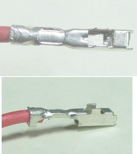

Can you Identify this Terminal?
Can you Identify this Terminal?
Can you Identify this Terminal?
Can you tell me what this is?  It is an open barrel crimp terminal and connects to a blade terminal which is about 1.5mm wide.  It is very similar to a GT150 terminal.  It has what I believe to be a manufacturer's identification mark at the crimp end.  The mark is stamped in and looks like an arrow with a triangle inside.  Do you recognize the manufacturer?
Thanks,
Andy
RE: Can you Identify this Terminal?
I don't think that's a manufacturer mark, only a "wire goes this way" mark.  Other than it being a pretty standard molex-style crimp terminal, what else were you looking for?  what's the wire gauge?  Any particular reason you can't pick a similar unit off of the shelf and use it, why the need for a direct replacement?
Dan - Owner
http://www.Hi-TecDesigns.com
RE: Can you Identify this Terminal?
AMP/TYCO or Molex would typically have their own mark where the arrow is.  The product is probably from a less known vendor.  Being tin plated, the application might be appliances or other lower priced products.
RE: Can you Identify this Terminal?
I can't help you with the manufacturer, but I'm pretty sure I've seen those exact terminals. If I recall correctly (50/50 odds of that...) they're used on the DC power plug for my Yaesu-brand ham radio (an old FT-77).
RE: Can you Identify this Terminal?
Update to previous: not the same terminals as on my Yaesu radio.
RE: Can you Identify this Terminal?
What is this connecter used for in your application?
