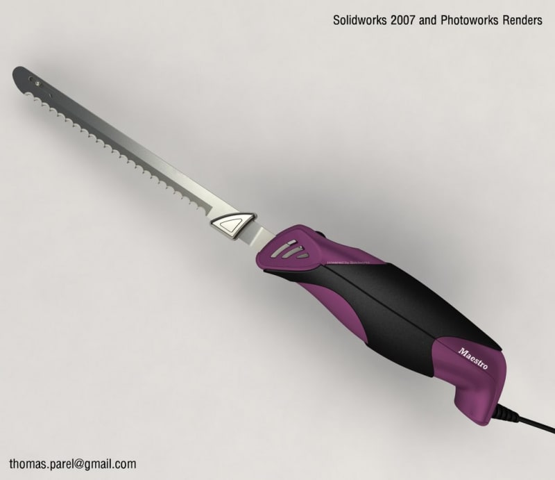

Well all the options listed above are good. However I think that you might want to look into 3DS Max/Maya and V-Ray or Brazil as they seem to be fast mainstream solutions for aimations.
Maxwell would suit you pretty well for stills.
I do have a seat of Maxwell, but have been able to get what I need from Photoworks. These are some of the renders that I get  with Photoworks,
 and some of the techniques used are discussed
 here (http://pareldesign.blogspot.com/2007/04/here-are-files-to-my-presentation-at.html )
RE: Rendering Solidworks Models
Yeh that's not too shabby at all. I noticed you're an Industrial Designer, is Solidworks the industry standard for Industrial Designers or are there other programs? I'm a Product Designer and I use Solidworks but would like to learn something a bit more freeform...

I would not consider myself a Photoworks advocate. As such if something better comes along I will jump on it. Photoworks has 2 things going for it.
1)Mental Ray Render Engine is fast and realistic
2)It is full integrated into Solidworks and saves time.
Solidworks seems to have "detuned" it somewhat. Softimage XSI and Maya have much more access to the inner workings of Mental Ray than Photoworks. For some reason Solidworks does not provide access like CGI programs do (probably like Matt Lombard said they are trying to dumb down the software so that everyone can play)
I totally get your frustration with Photoworks.
