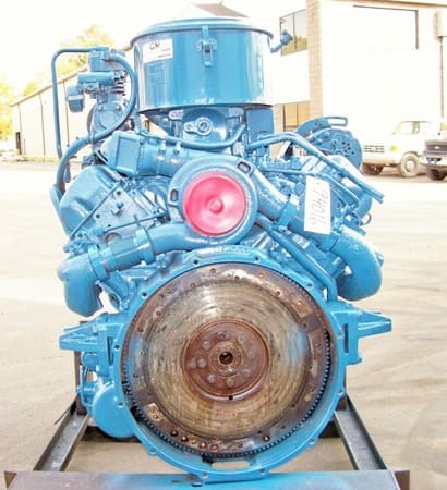

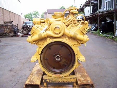

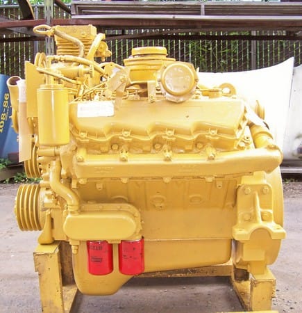

RE: Diesel design paradigm - V6 & V8
CAT and Detroit both had highway V-8's with turbos mounted in that location. Having exhaust in the back and the intake side facing forward made things quite simple. Both used a turbo with two exhaust inlets so the entire manifold-to-turbo plumbing consisted of almost nothing. Ultimately simple, but simplicity at the engine can cause headaches with the rest of the exhaust.
Even in turbo applications, intake plumbing is quite large so it is questionable that spacesaving or a reduction in convoluted plumbing would materialize from exhaust on top.
(Detroit=blue, CAT=yellow)
Note that both engines have the exhaust manifolds in the conventional position, radiating to the world and not each other, and there is a bellows between each exhaust manifold and the turbo, to allow all the pieces to grow without cracking each other.
