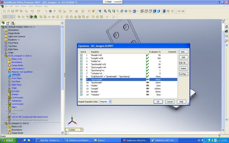

Hi, I have two parts in a asemmbly. They have linked measure and are two parts only a little diffrent. 2 part is based on part 1.
When i join these two together i have noe problems, but if i now go in the equationlist in the parts, I got a set of ekstra set of measures. And they are not green but have a 8'symbol. If I try to delete iam not allowed, and if i try to change the green ones, the message: linked value allredy exist.
I can delete it on the part, delete det extra value in equation, and link it one again, but when i update in the assembly they came back...
please help, sorry bad language iam norwegian.
[IMG=http://i38.photobucket.com/albums/e148/Nefertari_82/solidprint.jpg]Picture[/IMG]

The horizontal 8 symbol just shows the dimensions that are linked. That is normal and unless you are having a problem or receiving errors in your assy model, should be left as is.

OK, but I can't change the values, and that is the point with equations... If ill try Iam not allowd

You have to change the dimension that owns the link or you can right click the dimension and select "unlink value".
RE: Equation problems
You should be able to change the value in any of the linked dimensions in the graphics area.
I don't know why the Equation editor does not allow changing the value. This may be a bug or just a limitation. Either way, perhaps you should report it to your VAR.

yes i can change it if I:
unlink values, so delete the extra values in the equationlist. So link it once again. But when i update it in the assembely they came back :(
