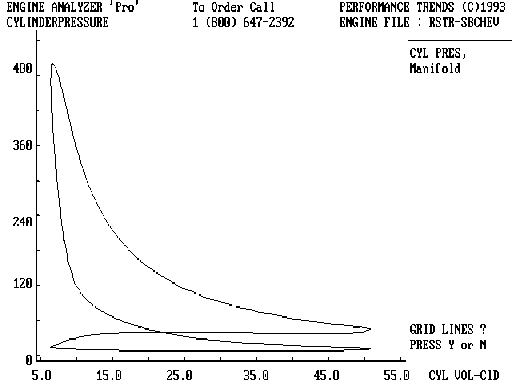

http://www.auto-ware.com/combust_bytes/pv.gif for a bang blow suck squeeze diagram.
It really doesn't change much in this example (the near horizontal line at the bottom). I think Heywood has more detail.

Greglock, again, thanks.  I'm  a ChemE, I just know the physics and practicle parts.  The vacuum doesn't change much, but I see that piston velocity isn't a factor, it's position of valves and piston in time.  Thanks.
