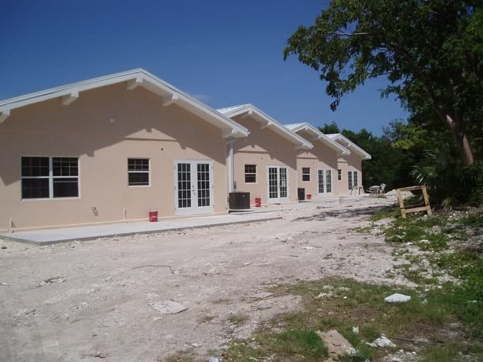

Here are sloping concrete roofs. The top side of the of the concrete is strapped with PT 2x4s on the flat to allow a means to fasten white reflective standing seam metal to the concrete.
In between the wood 'nailers' is 1.5 inches of foam. It is not as good as the Blue Dow SM or the Pink foam. Probably R4 per inch as a maximum.
The gable attic walls in the photo are insulated on the inside with 1.5 inches of the same foam. The wall paint is somewhat reflective.
The attic is not vented. This is in a year round cooling environment, latitude 19.5 degrees North.
I do not have the air conditioning started up yet, but I believe this will be more effective than R19 fiber glass at the truss chords and an attic that is a solar collector and humidifier. I am putting my money where my mouth is, these are my apartments.
Fiber glass also makes an air filter. It easily allows superheated humid air through. Difficult to have an attic vapour barrier in the tropics.
During sunny days with the ambient in the upper 80s, the under side of the sloping roof and the atttic air were both approximately 1F warmer than the ambient. I will condition the attic void with a little air, but I think I am going to monitor how the two middle units do, condition one attic and not the other.

The cold front passed and just a few minutes ago I took some readings, about 2:45 PM
Some quick readings that I have not analyzed.
Partly Sunny, in the shade outside about 82F dry bulb and 72%RH
The underside of the roof sheathing on the southern slope of the roof is about 112.5 F, used a Raytech MiniTemp
Some truss spaces only have the 3/8 buuble wrap as insulation, installed in a manner similar to line floor joists for return ducts.
Surface temperature on the underside of the 3/8 foil bubble wrap on south side of attic, again with the Raytech is 80.5 F.
Some truss spaces still have the friction fit R19, with the 'kraft paper down' rammed in betweem them, so the surface temp of the kraft paper was about 79.5F a degree cooler again measured with the RayTech. Again under south side of attic.
I stuck a thermocuple probe up in the attic above the foil and the air temperature was 91.5F. The air temperature under the ceiling tiles was about 75.8F.
It was hard to get an accurate tile temperature under just the foil or just the R19 due to placements of the diffusers.
Likewise, I can't easily get to the top of the foil in the South part of my attic, can do it in the north side, but not the same radiant heat as the sheathing is only 101 there.
