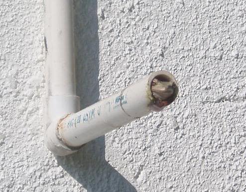

Underground cisterns are common here, still used in areeas where the muncipal supply is not piped.
They collect rain water and have it trucked in, however always a concern with open to atmospheric storage, besides germs there are frogs. May want a filtration/germicidal system like on some wells, see UV used sometimes.
Drink bottled water and wash flush toilets with the tap water.

Speaking of frogs, maybe terminate condensate drains with a 90

or underground to a french drain or a 'soak away'
