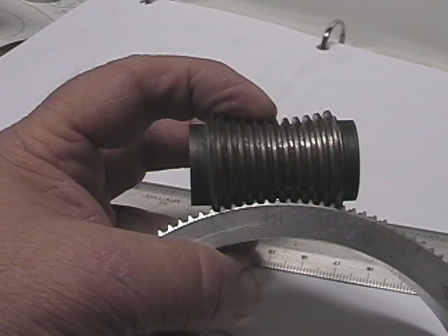

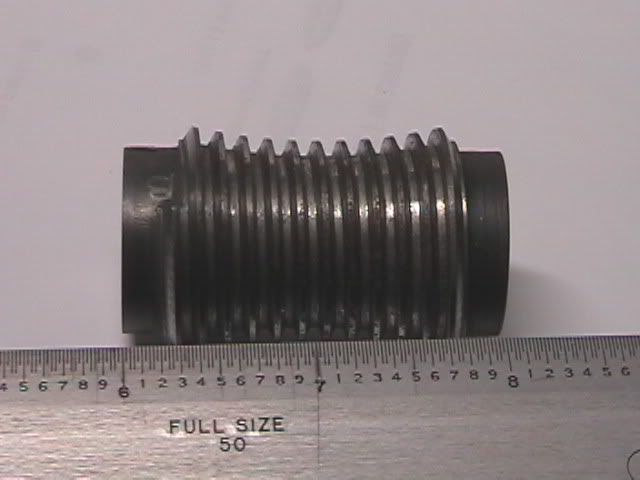

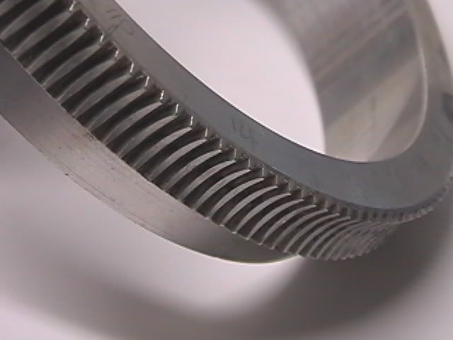

I know something of the subject, here is some pictures of a set.
Have not yet tried to draw one up in SW. Done spur gears, with hob runoff, Working on helicals at the moment,
Will think on it a bit & try to get back, also have Zerol & Spiral bevels, on my back burner.
Double Enveloping Worm Gear Set
[IMG]http://i37.photobucket.com/albums/e97/CURVIC9/GEARS06/PANA0412.jpg[/IMG]
DOUBLE ENVELOPING WORM (SUBJECT)
[IMG]http://i37.photobucket.com/albums/e97/CURVIC9/GEARS06/PANA0405.jpg[/IMG]
[IMG]http://i37.photobucket.com/albums/e97/CURVIC9/GEARS06/PANA0403.jpg[/IMG]
Cheers, Les H.

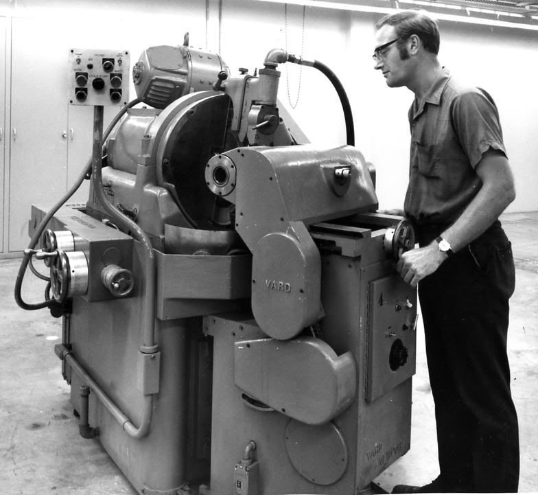

jacek0841 (Mechanical)
No,I am retired, I used to work for a company in California, [Vard Newport Inc], Had a Hourglass grinder that the founder had built, used a J&L thread grinder head on a custom built, (including the castings) base, it also had auto backoff for grinding the hobs.
When I worked on them it had languished a few years, so I got it going again, to hob them I modified a hobbing machine with a device that allowed rotating the part after reaching full depth, (the hob has to be thinned down). The hob first cuts on the outer ends, resulting in a scalloped center on the wormgear, then the wormgear has to be rotated about .005" a side to acheive proper form, (to remove the scallop).
The pics posted were from an early turret drive for the Apache, total backlash assembled .0010" - .0025". Measuring the worms now thats another story, but very repeatable and accurate.
Cheers Les H.

Have been searching thru my notes, found some stuff on the Vard Grinder, but not the notes where I had blank copies of the calculation sheets from the A.G.M.A. Double Enveloping Worm document. Do you have the worm and worm gear specs for the subject?
The Vard Hourglass worm & hob grinder.

Another shot of the worm I have. Which will be similar to what is being discussed.
[IMG]http://i37.photobucket.com/albums/e97/CURVIC9/GEARS06/DEWNOV06A02.jpg[/IMG]
