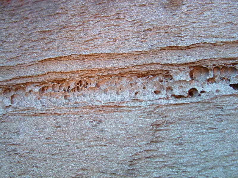

We're a downstream petrochemical plant in Australia, in a self regulated environment. We have an open topped, API12C, million gallon CS water tank as the main water supply to our firewater and plant "process water" pumps. Due to shell corrosion at the normal liquid level, the tank had to come out of service for repairs - its first time in 46yrs. This took quite some doing!!
Inspections to date had been via external UT surveys, which did not include angle scanning of the weld seams... in hindsight, that was quite some oversight!
One of the surprise findings was the extent of preferential corrosion of the shell weld seams - all of which have corroded to some degree - up to 30% strake thickness in some areas. Interestingly, the floor to shell weld is still pristine and most shell plate has general light pitting only.
Anyway, according to API653, weld seams need to comply with the asbuilt standard, which today is API650. API650 says that welds need to be full pen and full thickness... which is not a very fitness for service type of answer IMHO.
My question is this - must I repair near on 2kms of weld seams?? [$budget estimates $200k+]

Since many weld seams areas are still thicker than the locally thin minimum thickness calculation of API653 clause 4.3.3.1., can I pursue a "clean up, blend and stripe coat" technique to eliminate future corrosion of these particular weld seam areas, thereby reducing the scope of weld repair?? Am I within the spirit of the codes doing this??

I would blend grind (clean-up) the corroded area of the shell course welds to simply reduce the effect of a crevice which would also facilitate NDT, and then treat it as an LTA. I doubt you would have to do anything beyond running some LTA calcs to assure yourself of a sanity check.

On the topic of LTA's, we're talking weld seams, so any blend grinding would end up with grooves of about 0.5" - 0.75" in width. The depth would be up to the minimum required thickness per API653 4.3.3.1b) with the radius in some locations quite small (doube V, square butt type weld) since the welds would need to be chased/blended to remove most of the honeycombing. That leaves me needing to assess using API579 section 5, groove assessment. My stumbling block with this becomes the length of the groove.
A groove might be ok in isolation for a short length, but API579 isn't set up to treat extended grooves, and the issue is that the entire tank's shell welding is impacted.
Short of an FEA solution, I may need to go with the reweld option and that's big unplanned biccies...
If welding is the pathway I finally recommend to management and wear the heat, then I'm thinking of an arc gouge and flux core type welding spec, basically to speed up the process and reduce the cost.
For your edification, some examples of the corroded weld seams...
Some pics:

Despite the rather unattractive locally corroded surfaces, since this is an atmosphere water storage tank, you might be surprised as to how much design margin there is with the remaining wall thickness. In lieu of additional welding, you might be able to get buy with blend grinding the corroded locations and coating the interior surfaces to preserve the remaining service life of the tank.

Close investigation of the lower strake welds show greater loss than first thought. API579 groove based LTA calcs say that the bottom strake welds need repair... the welds on the higher strakes though look to be blendable and coatable... I knew there was middle road.
