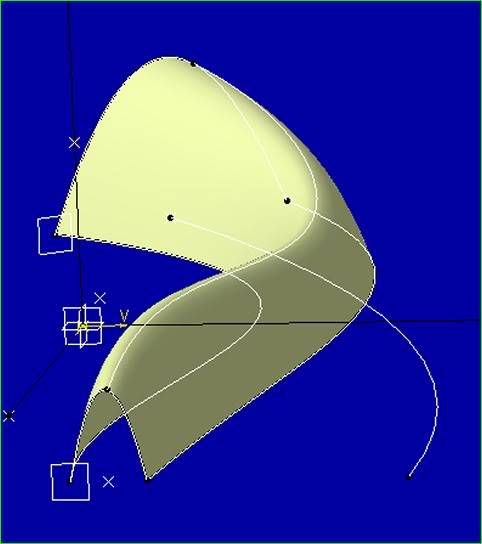

It’s been a couple of years since using V4 but I need to create a surface which is completely controlled. ‘GSD multi-section surface’ doesn’t seem to allow me to select guide curves or limiting curves, just 1 spine.

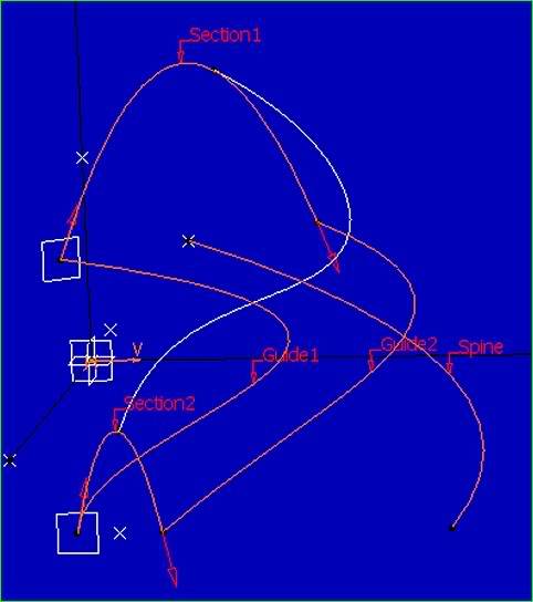

The GSD Multi-Section Surface Definition box defaults to Section Curves first - see the top line of the top white box is a solid dark line. Select the curves.
To define the Guide Curves, left click the top line of the second white box - to activate it, now the Guide Curves can be selected.
If a Spine is to be used then click Spine and click on No selection before actually selecting the curve to use as a spine.

Thanks Guys. The problem was as simple as activating the ‘guide curves’ box. I need a V5 surfacing course.
