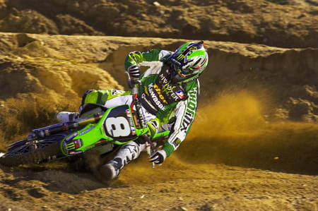

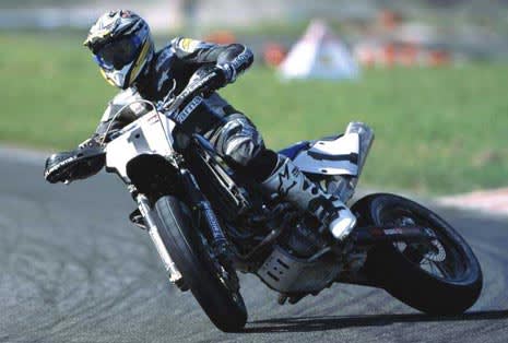

Then there's variables to the variables. One of the best ways to leave a birmless corner is with the rear wheel slightly sliding, the front wheel a bit off the ground, and both feet on the pegs. This can happen on pavement too. At any rate, to quantify the situation in math, one would have to be extremely skilled and have nothing better to do.
birm:
No birm:

You will notice in both photos the riders are sitting forward weighting the front wheel.
