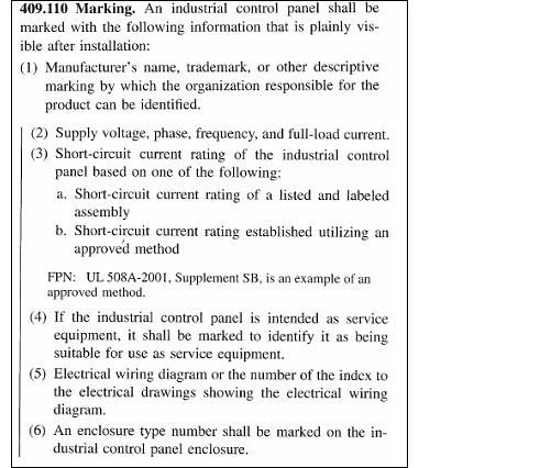

RE: PLC and Hydraulics Pictures
Thanks fbcybil; You realize that the three wires coming out the front are just a test jury rig?
dbaird; Thanks much for the input! On the "list" you provided, the last item, I'm not sure on; "enclosure type" does this mean NEMA 4X ,12 etc? or?
On the original unit I'm replacing they had taken to writing on the face with Sharpies then to erase the marks they used a can of spray paint... I came up with the double silk-screening (white blocks) which I titled "NOTES".  Then I stuck grease pencil on the front hung from a 3 inch chain and a magnet to allow comments to be written in the note areas.  Comments like, "leave this gate off!".   I'm interested to see if my scheme works.
