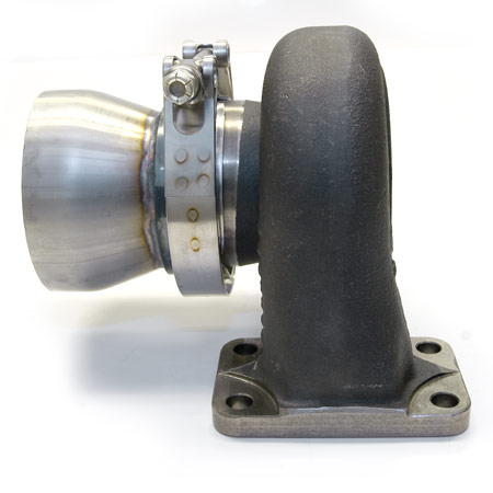

I think you may need to also consider exhaust manifold and exhaust outlet design if stepping up to the larger frame turbo so you can spool it up and keep a decent power band. You could consider the following:
1. Going to a divided turbine housing (if offered) and use a pulse manifold, keeping it short as possible whilst not compromising flow.
2. Use a manifold material with a higher service temp and also some form of turbo support. This will allow you to use a thermal blanket or some other form of insulation on the header to increase exhaust temp to the turbine. You need to make sure the turbine housing and wheel can also cope with the higher temps.
3. Use a conical diffuser after the turbine. This is often used in turbomachinary to improve the pressure recovery after the turbine and improve its efficiency. Included angle is normally around 7-14 degrees. It should expand out to the diameter of your exhaust i.e. 3-4".

Womble,
First off thanks for the reply.
Secondly, I am planning to move up to the T4 divided housing with a new manifold design using 321 Stainless. The current manifold I have is 321 and it has held up to track usage and moderately aggressive anti-lag.
I am inquisitive about the usage of the diffuser. To a certain degree the v-band housing seems to incorporate a similar tactic. Albeit more for packaging reasoning, it might be easier to rework it to my current setup.
http://www.atpturbo.com/root/releases/images/release091905/3_TO_4INCH_TRANS_FEAT3.jpg
