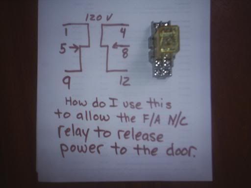

I have a 120v cube relay but do not know how to wire it to control a motor thru a fire alarm relay. The fire alarm relay can only handle .5 amp. When the fire alarm goes off the relay will open and should drop power to the motor operated doors. I burned up the first relay using it as a switch

My terminology may be wrong. The cube relay that I have has a contactor and two sets of N/O and N/C relays that change state when 120V is applied. I don't know how to wire this to make the power drop to release the doors. Thanks

treas; can you sketch what you are trying to do.  I can see your terminology is very confused and we will all be talking in circles.  If you can provide a sketch then we can skip the terminology.
Draw it in something that you can produce a jpeg file from then you can post it in here.  See how to post in this FAQ: FAQ238-1161
You can even draw it on paper with dark ink and take a photo of it.  Just make sure it isn't too big a file when you have it in jpeg form.

Seems like this door motor should already have an operating contactor.  You just need to wire the fire relay N/C contacts in series with the device (relay, pusbutton etc.) that may energize the existing contactor.  This will prevent operation of the door when the fire relay is energized.

Semantics, semantics, semantics.
Contacts are the switching components of relays and contactors. Contacts have ratings based upon their ability to switch different types of loads. Motors are difficult loads to switch, so the contacts must be capable of that type of duty or they will not last long. The contacts in the fire alarm are NOT rated for switching any appreciable motor load, so they must switch another device on and off, and that 2nd tier device would be the motor controller, be it a relay or contactor.
A contactor is just a name given for a relay with heavier duty contacts specifically designed for motor or other difficult load switching. That isn't to say that relay contacts are not motor rated, some are, but that is not their primary design criteria. Relays are typically designed so as to switch very fast and with low power consumption, contactors are not.
Heavy duty itself is a relative term. The relay in the picture IS a heavier duty device compared to the .5A contacts in the fire alarm relay. The relay appears to be an Idec RH2, with contacts that are indeed motor rated for 1/3HP at 240VAC, or 1/6HP at 115VAC. If your motor is that size or below, you can use this relay to switch the motor on and off, you will not need another "contactor". If the motor is larger than that, then don't bother with this relay, go buy a contactor.
Now as to the wiring, you did not post any details on the motor, it will make a difference.

Thank you to those that had helpful comments. I was able to bypass the the .5 amp relay by wiring the 120v thru the pilot relay shown, and still allowing the fire alarm signal to initiate the closing of the doors. Thanks again.
