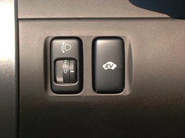

Due to the way Americans test fuel economy, Toyota just deprived Americans of the EV button on the Prius. The EV button stands for Electric Vehicle, though you might be forgiven for thinking it stood for European Version. You can run the Prius for short distances as an electric vehicle by pressing the EV button, eg if you want to silently run over the neighbours dog for fouling your lawn, instead of scaring it off.
Then, to extend the range, just add more batteries.
To make it a plug-in hybrid, just recharge it overnight.
Like the CalCars guys say, "it's not rocket science".
