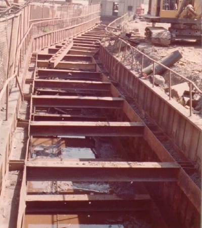

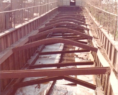

Loading is not always as predicted. This is a photo of a (permanent) 10' deep, braced steel sheet pile drainage canal adjacent to a railroad spur on steel mill property (the track is just out of the picture on the right). We had the contract to repair this damage, under what would be called a design-build contract today - the Engineer-of-Record paid for the repairs since he had underestimated the lateral forces.

More details please.  The sheeting walls still look fairly straight yet the cross braces have bent upward.  There seems to be a good number of braces, fairly close together.  The track is not visible so I would think that it's not too close to the wall.  Did you determine the cause of the failure?
RE: Underground parking adjoining railroad
Note the cross beams are connected to two I-beams at each side of the sheet piles.  Looks like both I beam at right forground and some of the cross beams have elastically deformed.

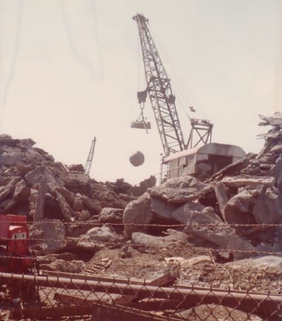

PEinc - The track was about 20' from the canal. Beyond the track was the steel mill's slag pile, which was being continuously broken up for rail shipment. This was accomplished by picking up & dropping a solid steel ball (about 4' diameter) with an electromagnet. Here is the ball in free fall
What the Engineer-of-Record (a respected, national infrastructure firm) had not considered was the liquefaction of coastal soils caused by the steel ball impacts (you could not only feel the impact, but also see everything shimmer; real "man-made" earthquakes). The sheet pile walls had moved together a few inches over 7 years.
Three failure modes:
1. Horizontal struts buckled when the wale webs yielded & the strut/wale welded connection held.
2. Struts remained straight when the wale webs yielded, but the strut/wale connection failed.
3. Struts remained straight when the wale webs crippled.

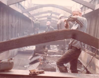

Here is a photo of repair work in progress
Repairs amounted to replacing both the W6 struts and lightweight W12 wales with beefed-up, used HP 12.
Nothing fancy, just a brute-force, conservative solution - as being suggested for rbarn's temporary shoring.
