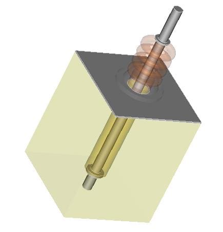

In insulated medium such as oil, FS6 or vacuum, the creep distance may not be as significant as in air where is required because of the interaction of contaminant and humidity conducting bands. Sample of that are the transformer bushings with strait insulator inside the oil and irregular configuration to increase the leakage distance in contact with air as show in the enclose figure
On the other hand, clearance of static equipment such as transformers, depend primarily of the dielectric strength of the oil and geometric of the conducting parts (electrodes). If the electrode will create arching such interrupting devices, additional consideration and clearance reduction should apply. Humidity in oil and contaminating particles also contribute to reduce the insulating strength of the medium.
Here is a graph that may be use to determine the clearance in insulated oil.

cuky2000: Thanks for that.  It'll take some time to put it to work, but it's a good, sensible start.  I'm thinking these are not your drawings.  If they are...triple thanks.  Can I have a doc that I can reference?

Is creepage really an issue at all under oil, SF6, within a nitrogen blanket, or even dry air inside equipment? Don't believe I've ever seen a creepage value specified for that part of a bushing below the flange.

I agree with Stevenal. I don't think creepage is even a relavent parameter under oil or basically any system not exposed to outdoor-like environmental conditions.
As for the space requirements under oil, it very much depends on the type of oil being used. Some oils have better insulating properties than others.
