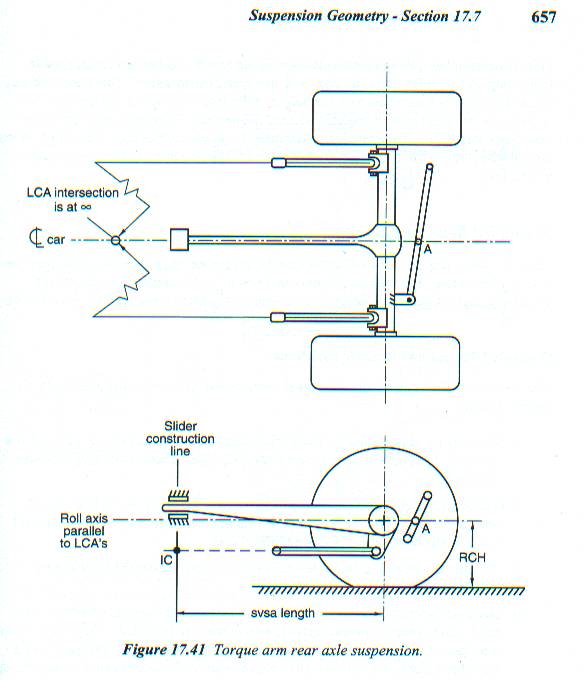

Can anyone tell me where the IC is on a torque arm GM with the TA setting parallel with the ground and the lower control arms with a slight uphill angle rear to front?
The two lines will intersect but at a great distance in front of the car. Is the lines intersecting point the IC or is somewhere else?

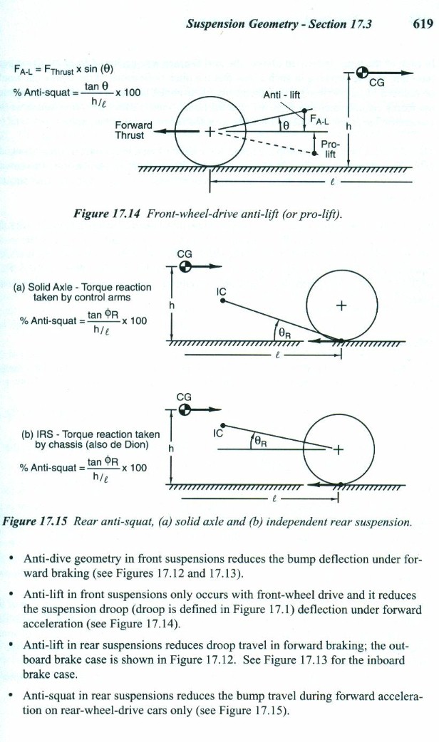

If you are ever in doubt draw a free body diagram for the axle and each arm. This will give you the forces (and the directions of them) on the body, which you can use to directly estimate the pitching effect, which is probably what you are interested in.
For some IRSs it is quicker to work out the pitch gradient (ie degrees pitch vs acceleration) than it is to mess about trying to find ICs.

If the lines through the LCAs intersect "at infinity", all that means is that they do not provide any lateral location to the axle.  Intersecting at a finite but great distance ahead means you get only a little help with axle lateral location.  This affects things like axle rollsteer and handling, but not anti-squat and load transfer to the rear wheels under acceleration.
As far as side view is concerned, the IC is a combination of the TA and LCA inclinations and the TA length. Drop a line that's perpendicular to the TA (as defined by the axle shaft center and the TA's chassis end pivot) from the TA's chassis end pivot point.  Where the line through the LCA pivots intersects that perpendicular line is your SVIC.  The Millikens' "Race Car Vehicle Dynamics" has a good picture (Fig. 17.41) and description.

The SVIC can be at a "real" TA's front mount, but that would only be by coincidence.  That the TA's front mount must in some manner accommodate plunge by the TA means that the IC is normally elsewhere.
Umm, perhaps it's time to ask just what kind of car/rear suspension is involved, just to make certain that we're thinking of the same thing.  F-bodies (and I think the various Vega/Monza platform variations) used a true torque arm, but what was termed a TA in the GNX (and in Kirban's early advertising copy for their identical product) is something else.  That one is also capable of resisting fore/aft forces (and had better line up pretty closely with the front LCA pivots as seen in side view for anything resembling reasonable street operation).  In the GNX arrangement, the SVIC is always at the chassis pivot of the traction bar/single ladder bar component that attaches off a reinforced diff cover, and this may be introducing some confusion.
With a torque arm, what you do know is that the TA's front mount ideally sees only a force that's perpendicular to the TA (assuming either frictionless sliding within a bushing or a double rod-ended vertical link arrangement).  That force points to the IC, and you should be looking at the physical length of the TA and the virtual length along that force line as making up an L-shaped arm.  You also know that the LCA forces point straight along the LCAs and must also be aimed at the IC.  That's what defines the arc through which the axle moves, even though the vertical force can only be applied at the TA bushing.  The anti-squat property of this arrangement is mostly a function of the LCA inclination and TA length, with TA inclination having relatively little effect.
A GNX style piece is different.  In its OE configuration it is much shorter relative to the wheelbase than the F-body TA is to its.  The arc in side view that the axle must follow can be completely defined by it alone.  That leaves the LCAs responsible for axle end fore/aft location and (some of) the fore/aft force only.  Raising the pivot of the GNX device is going to have a far greater effect on IC position and anti-squat than raising a TA bushing end.  If its pivot wanders very far from the LCA pivots the rear suspension will tend to bind up, as the LCAs and the traction arm will start having different ideas about the arc that the axle should be following.  One conceivable end result would be for some rear end lift to occur (assuming >100% anti-squat), followed by whatever compliance remains in the suspension bushings to be used up resulting in an increased tendency to lift the front.  It's your mention of the sensitivity of the suspension to only 1.5" pivot relocation that has focussed my attention in this direction.  If I'm off-base here, just ignore it.

It's not the intersection of the TA's axis itself and the LCA axis that you're looking for, but the intersection of the LCA axis and the force line which is along the axis of your TA's chassis-end link.  Under load, which probably differs from its static orientation.
I'll take some responsibiity here, as I had initially described an OE configuration where the [force] "line perpendicular to the TA" is directly tied to the TA's inclination.  That's where the TA with a link differs, as the link can be at any angle with respect to the TA.

For me the easiest way to wrap my brain around a suspension like yours is to think of it as a 3-link.  In essence the TA is just a 'very long strange shaped link bracket' just like the short brackets that connect the axle tube to the lower control arms.  Just think of the torque arm as a part of the rear axle housing and not as a link or control arm.  The real 3rd link would be the one going from the chassis end of the TA to the chassis (short and almost vertical).
If you are using a suspension software then start with a template for a 3-link + Panhard bar suspension and ignore the TA and use the short vertical link instead.
This is a link to the figure that Norm was talking about
[img]http://www.jonaadland.com/Ta.jpg[/img]
[img]http://www.jonaadland.com/Antisquat.JPG[/img]
(I didn't scan those and take no responsibility for the copyright)
