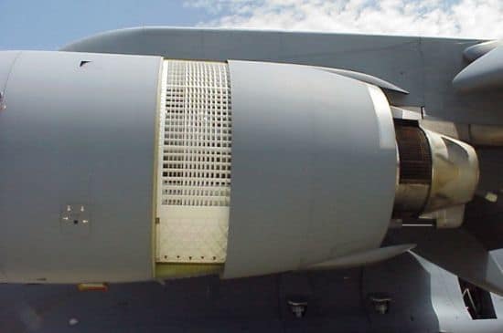

Hello everyone,
I'm reverse engineering a latch that is used on a "blow out" door of a turbine engine thrust reverser. I like to know exactly what the part's function is, but I'm stumped here. What exactly is the function of this blow out door? Does it simply alleviate an overpressure in the nacelle? Does it operate only in flight, or during thrust reverser actuation? I believe it is located aft of the thrust reverser air stream which makes me believe it is really intended to operate during flight.
Any ideas on this?
Thanks in Advance,
Chris Marinelli

SparWeb is correct in that I am only interested in a Latch with a spring loaded cam/detent overpressure configuration. It is on a CF6 translating cowl TR which may very well be the lower picture of SparWeb's post. It is essentially a spring-loaded roller attached to a small bracket that rides on a cam with a notch. The roller 'cams out' of the notch when sufficient torque is applied.
I've visited OH shops in AirCanada and SW, and am scheduling a visit to Lufthansa and possibly Delta. Unfortunately, it is difficult to get significant time in the shop as the technicians need to get their work done.

Blow-out doors can be found in several areas of an aircraft, mainly in areas where there is a risc for a powered system failure.
Think of it as a pressure valve, its purpose to efectively "blow out" and in doing so preventing ar minimizing the damage to the aditional structures or engine by releasing pressure. Most common are in the engine cawling and some in the wing to body fairing.
Usually these are rather basic assemblies but their importance could not be understated. They are designed to fail in certain conditions thus making them too strong minimize their effectivenes.

Cmarinelli, et. al.,
Forgive me WKTaylor & MintJulep, but we've had enough philosophy for one thread, IMHO, and should just get on with the topic.  So I'm going to share a secret with you; one that I haven't revealed before on the forum, but I just want to move things forward.
Overhaul shops are great places to visit to chat with the folks who work with this equipment daily.  They know it inside and out.  But the gleaming OH facility is only one stop on the journey.  These guys also have junk bins  that are pure diamond mines for inquisitive engineers looking for parts to reverse engineer.  Get some tossed-out latches plus some of the other key parts of the system, if you can, and take them back to your office.  Not only will you see how it works, but you'll also see why they FAIL.  After all, they were thrown out for a reason...

Hello, I work in a big company which conceives and makes reversers . If I  understand the question, doors serve in case of high pressure and can open in flight. The cable which holds them serves for protecting hinges and openings of trapdoor.
I worked on the development of A380 and in particular on these trapdoors.

blow out doors are a safty feature that relieve the spike pressure resulting from a 'burst duct' overpressure in the engine compartment.  we actually designed one reverser without them in the hopes that the structure would 'burp' itself in the event of a burst duct.  It is a very difficlt thing to analyize so we just put in a blow out door in most cases.
