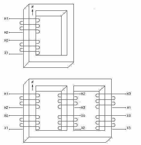

Let me rephrase the original post in electromagnetic terms:
Suppose we impress Vab (3 ph source) to both H1-H2 terminals of the above 1ph tx and 3ph tx so that they are in parallel.
The X1-X0 will be in phase with H2-H1 phasors on both transformers so that both X0 terminals can be grounded at a common point. X0-X1 will be 180 degrees off-phase wrt H2-H1, so what happens if we connect the X1 terminal of the 1ph tx to the X0 terminal of the 3ph tx?
We know X1-X2 is 30 degrees off-phase wrt H1-H2 on the 3ph d-y tx.
My electromagnetics is rusty and I am hoping someone out there can enlighten.

Nothing!
Two separate Tx have nothing to do with each other.
